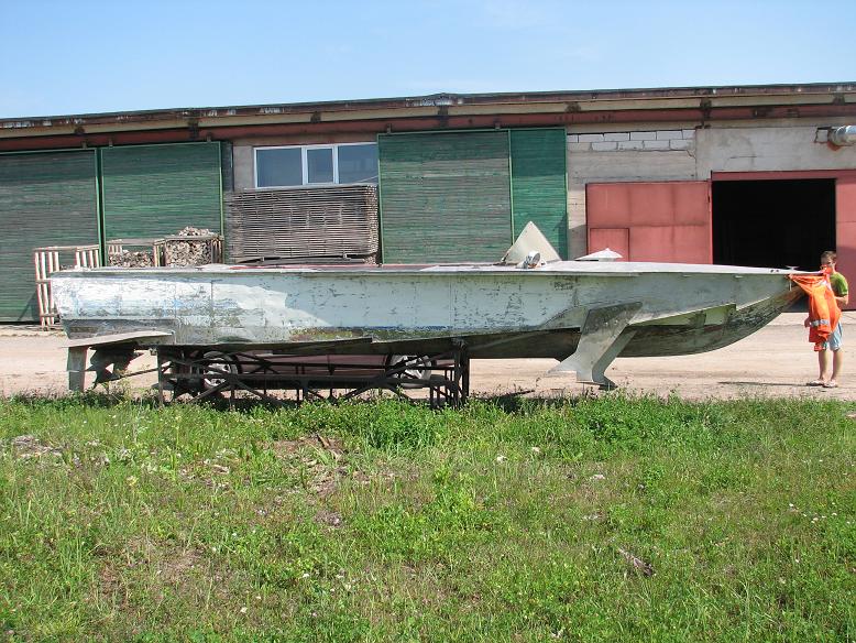

My first real story with pictures included. These days, i transported my volga from a small city in Latvia to another small city in Latvia, haha.
Interesting, because it was quite a challenge to get the boat out of the old wooden shed. We eventually got it on the truck. The journey went smooth.
At the place of destination, the truck driver wanted a lot more money than we agreed, so my party mood went a bit away.
The previous owner had started to take the paint off with far to ruff material, that's why it looks so bad. I will do soda blasting (off course). Besides that, it looks rather good.
taking the boat out of the shed
So the boat was placed on the new spot an i started to strip it completely. Hard work, because it was already 34 degrees, and i was able to fry an egg on the aluminum deck.
new destination
new destination
