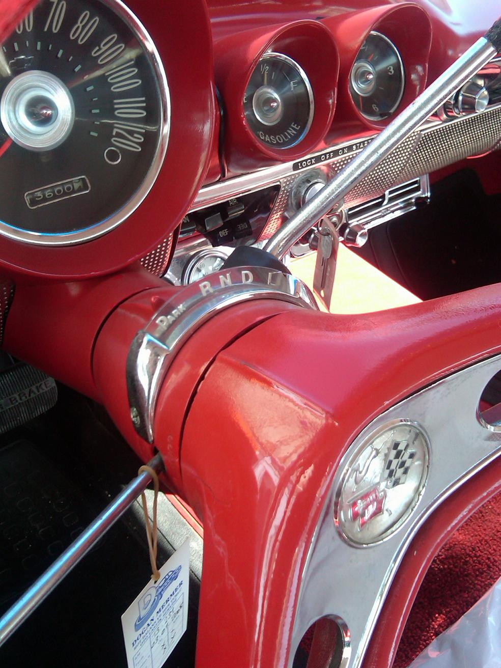

This is, what it looked like on a 1960 Chevy!

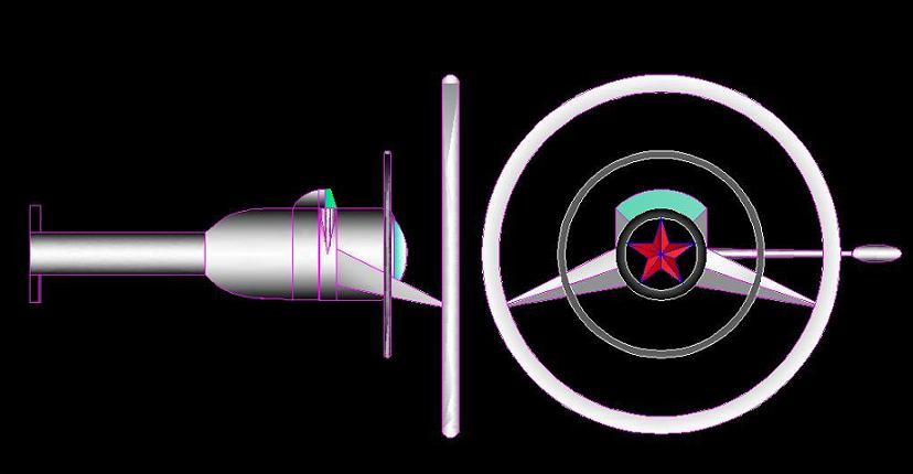

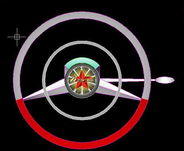

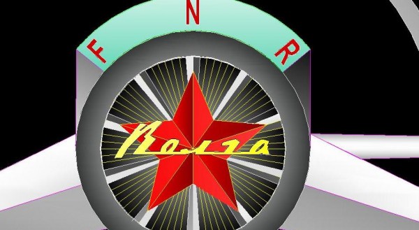

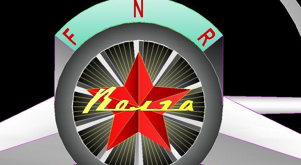

Here are some updates on the last version of the steering wheel. It became somewhat more baroque...
Leather lower part, plexiglass horn doom with Volga logo type flashy CCCP.
Mind the logo! It took me some time to make it. Clean copies are available in AutoCad!
Re: Electronic or electro-mechanic control of engine and gearbox
Close-Up on Horn badge
PlexiGlass horn Badge

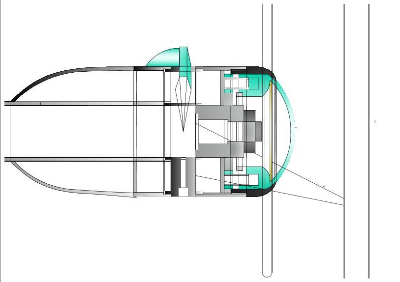

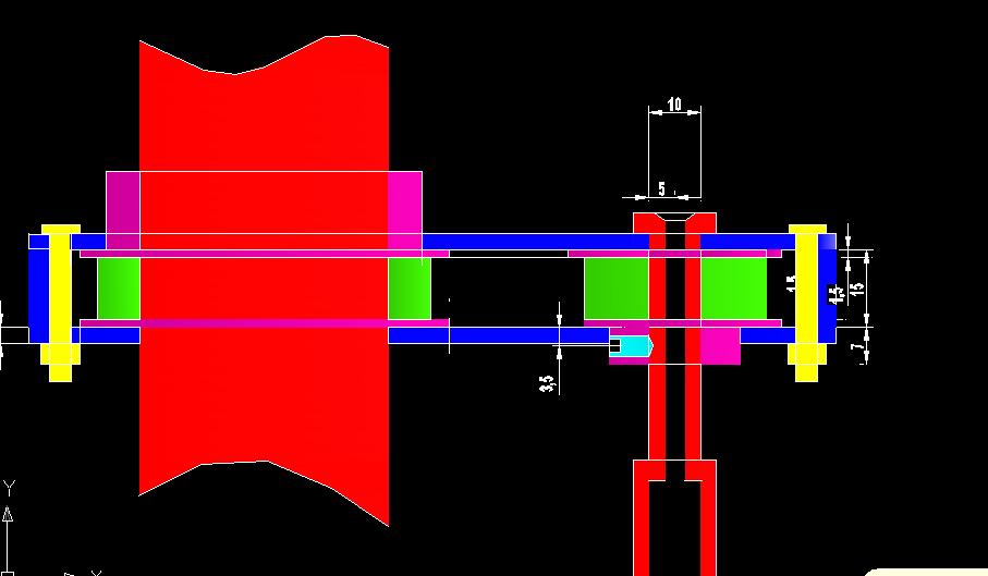

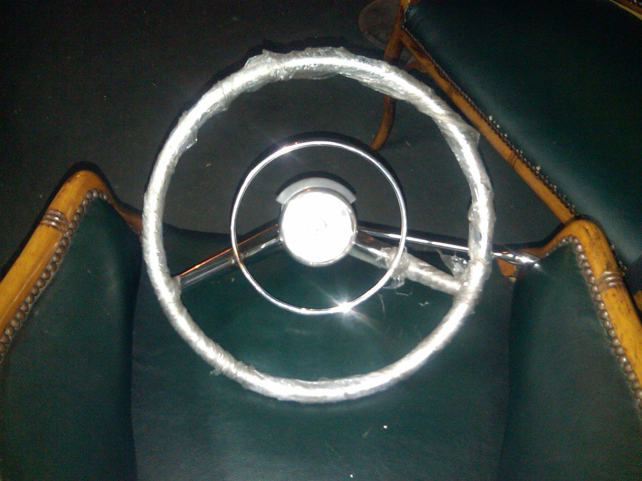

The sectional drawing was something I forgot to add here... Here we go...
We are still struggling on this ...
Sectional drawing of steering wheel.JPG (35.68 KiB) Viewed 526817 times

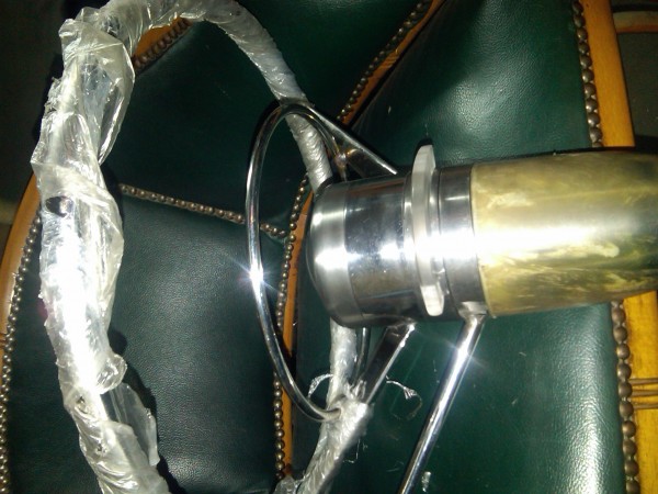

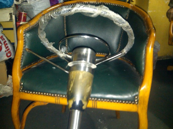

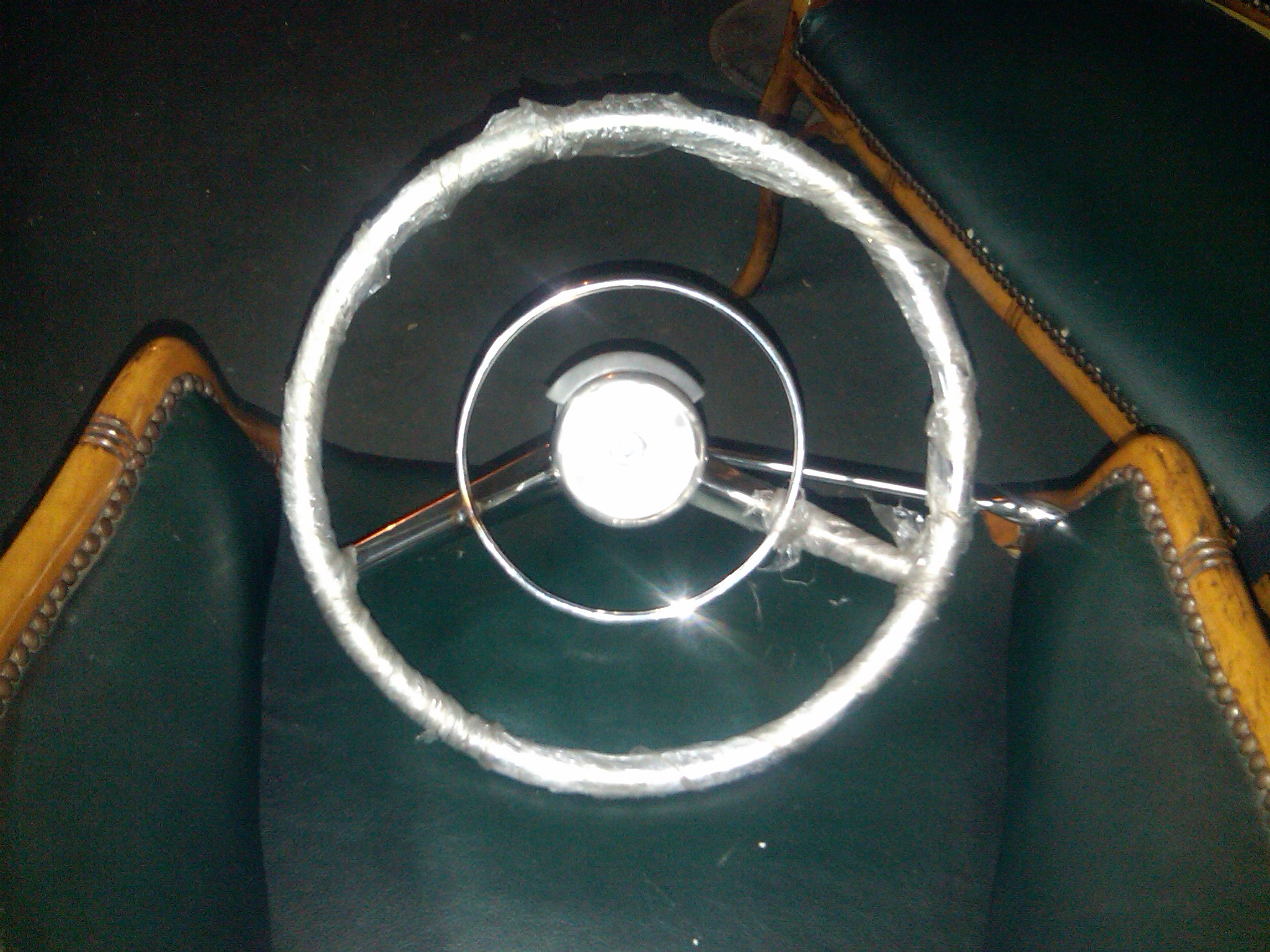

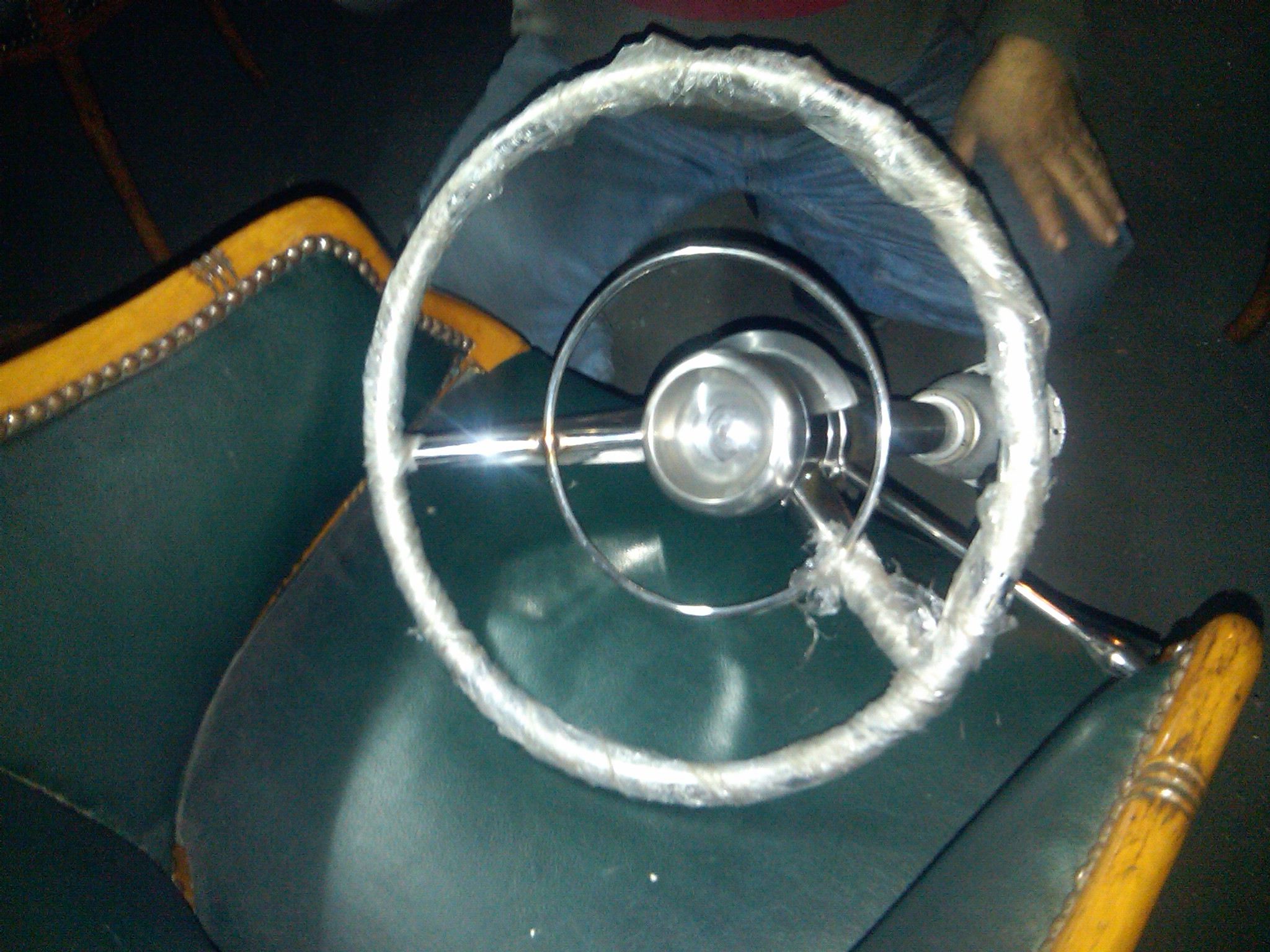

The machined steering wheel, rest is still waiting for finishing.

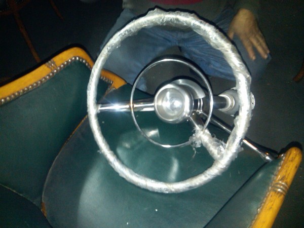

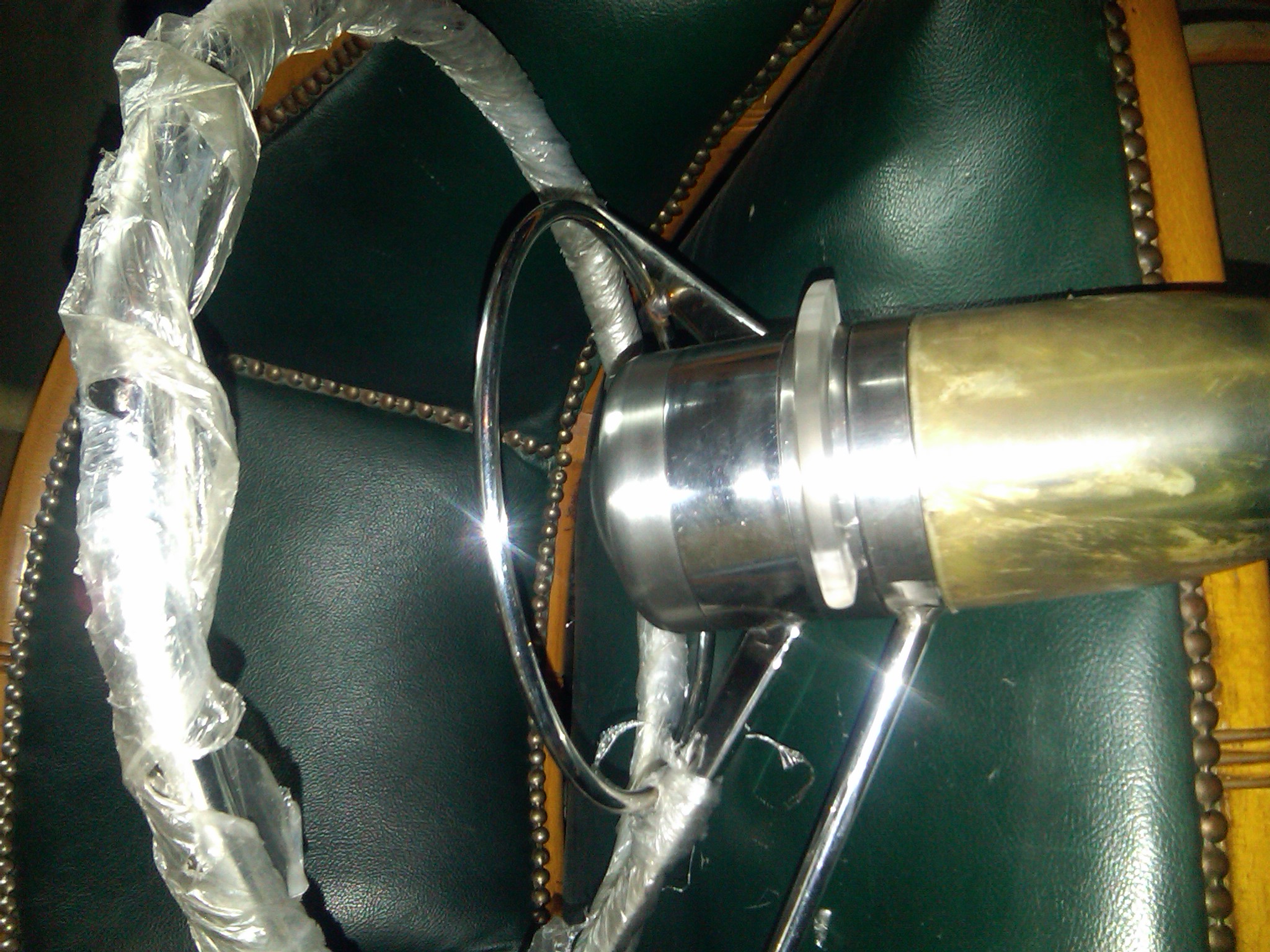

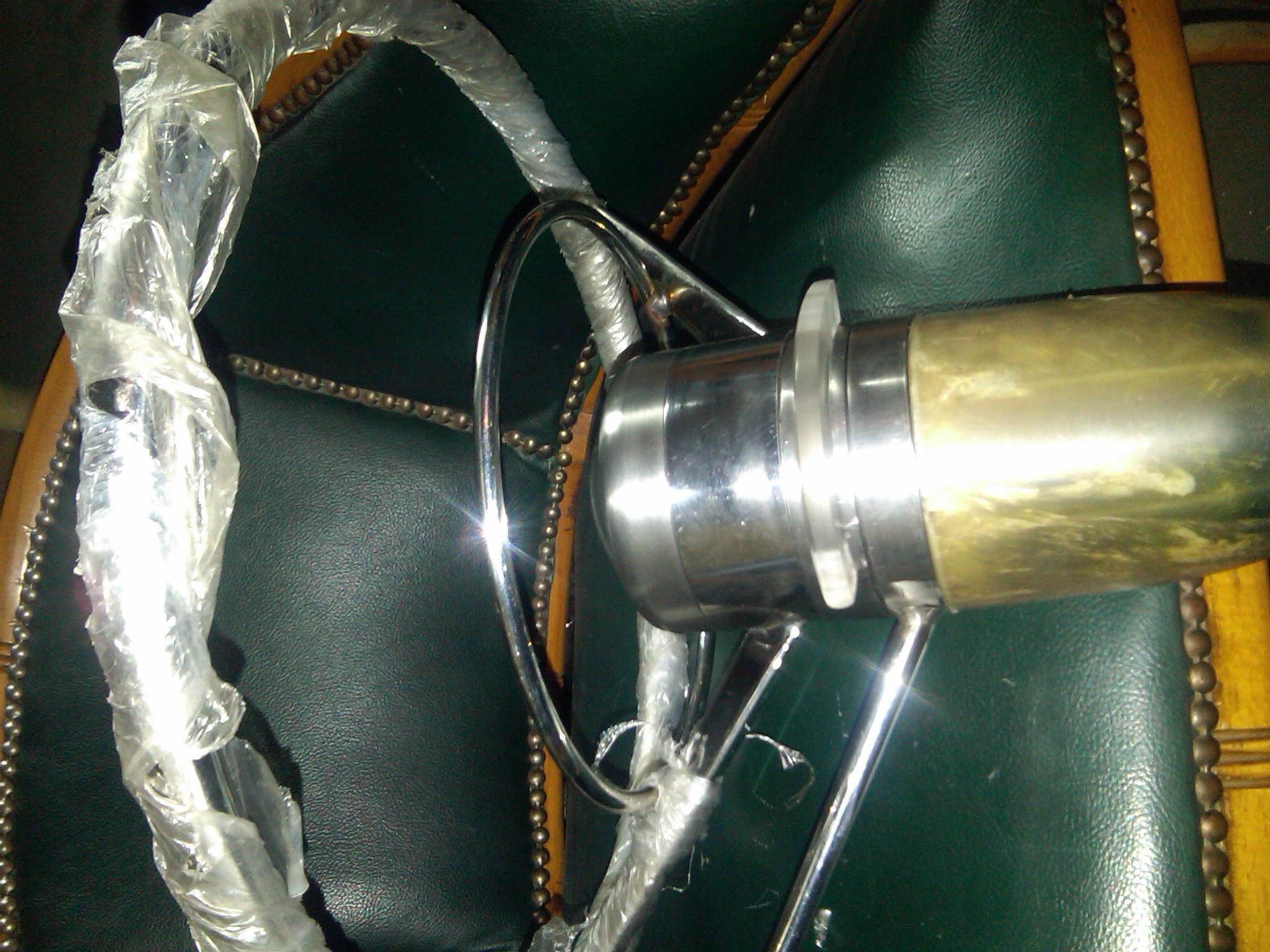

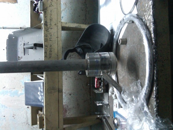

Some more photos for updating the progress ...
There is still some packing material on it for protection.
it will be removed, once we attach the leather.
b
b
a
a

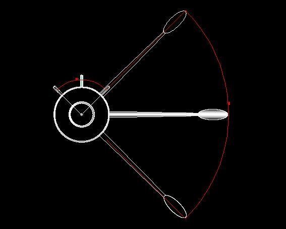

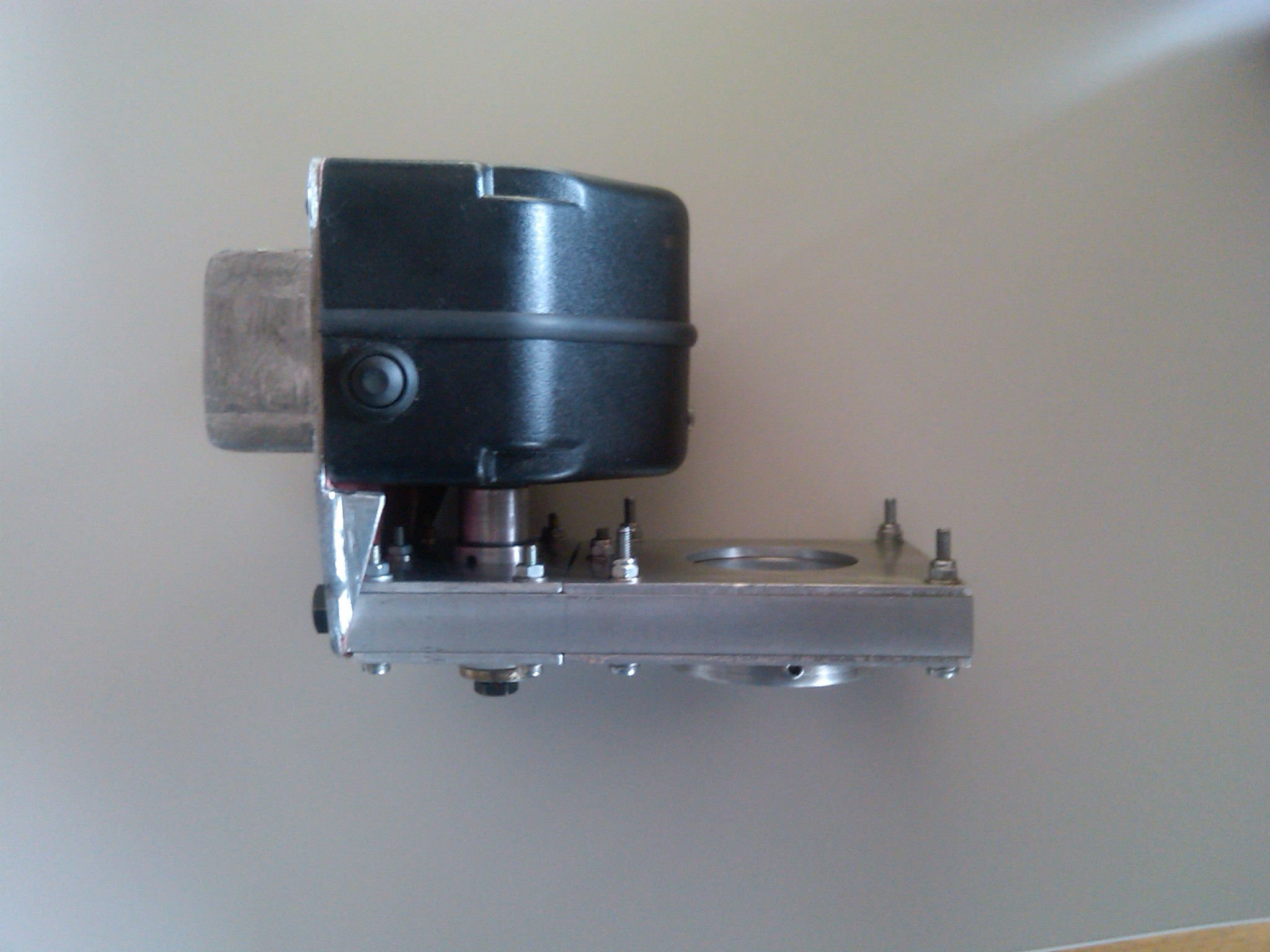

Lever moving 90 degrees
Lever Movement.JPG (16.52 KiB) Viewed 526746 times
90 degrees is steped-up to 160 degrees to move a potientiometer of a ready control head lever (Mathers)
The movement is being transfered via toothed belt drive box.
Trigger belt enables the transmission

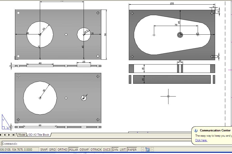

Revised mechanics.JPG (27.88 KiB) Viewed 526692 times
The box is out of aluminum and consist of 3 plates, bolts and nuts.

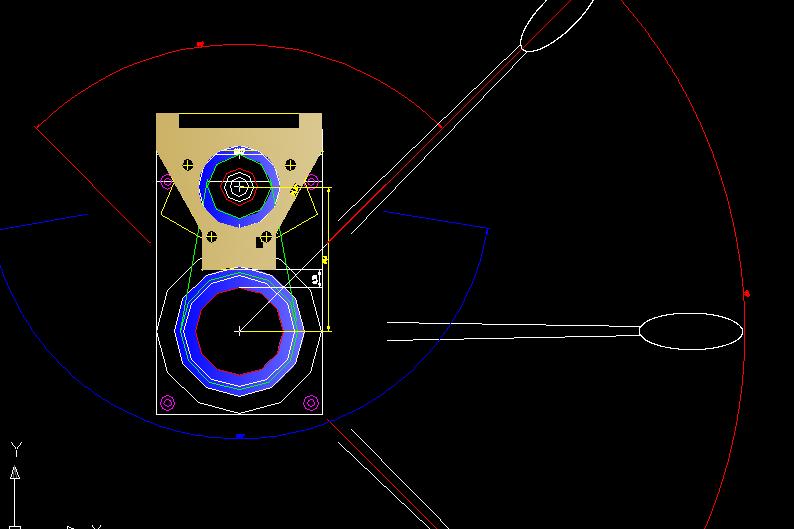

Here is the production drawing.

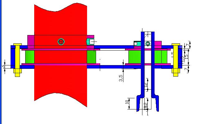

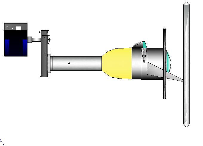

Sectional drawing of the step-up box.
beige became our favourite...

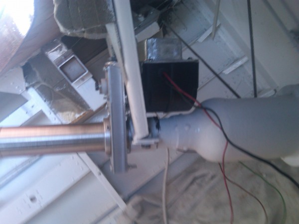

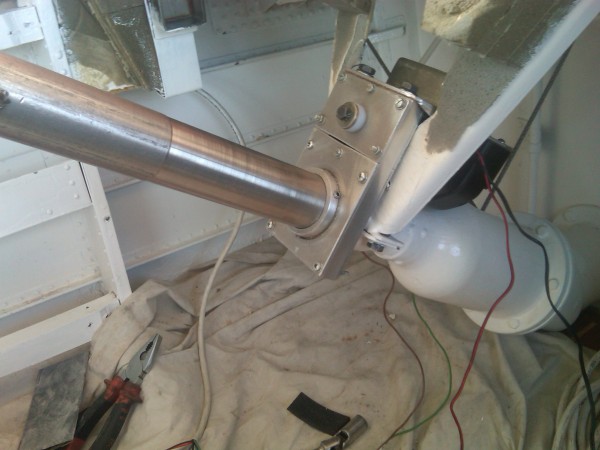

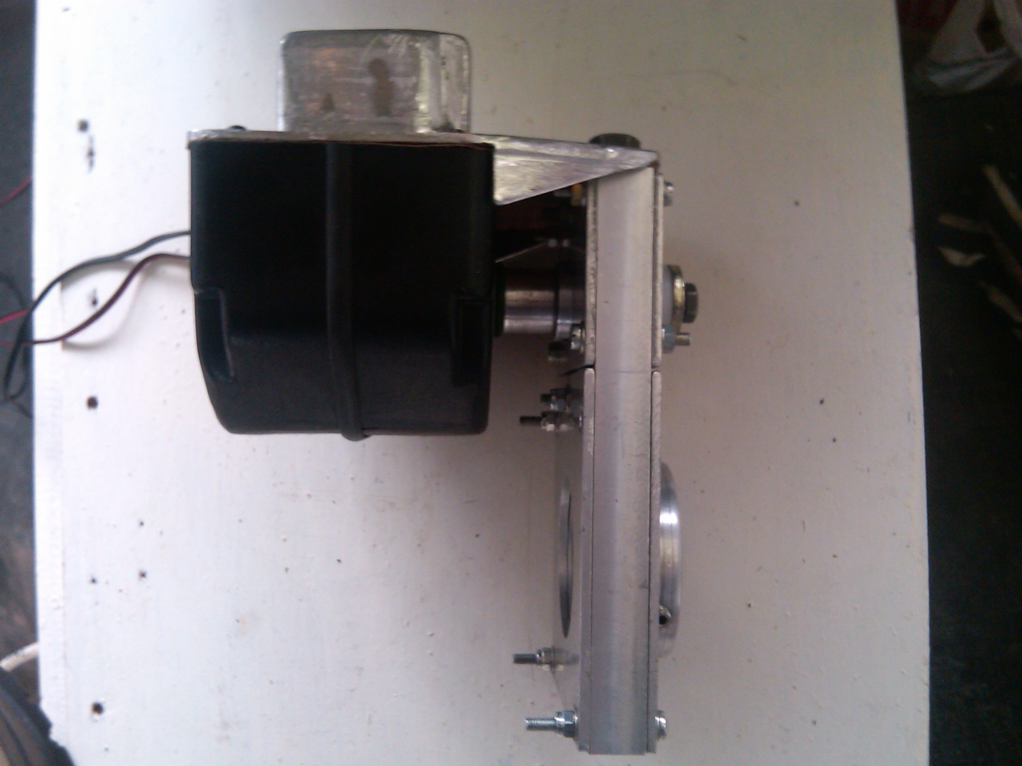

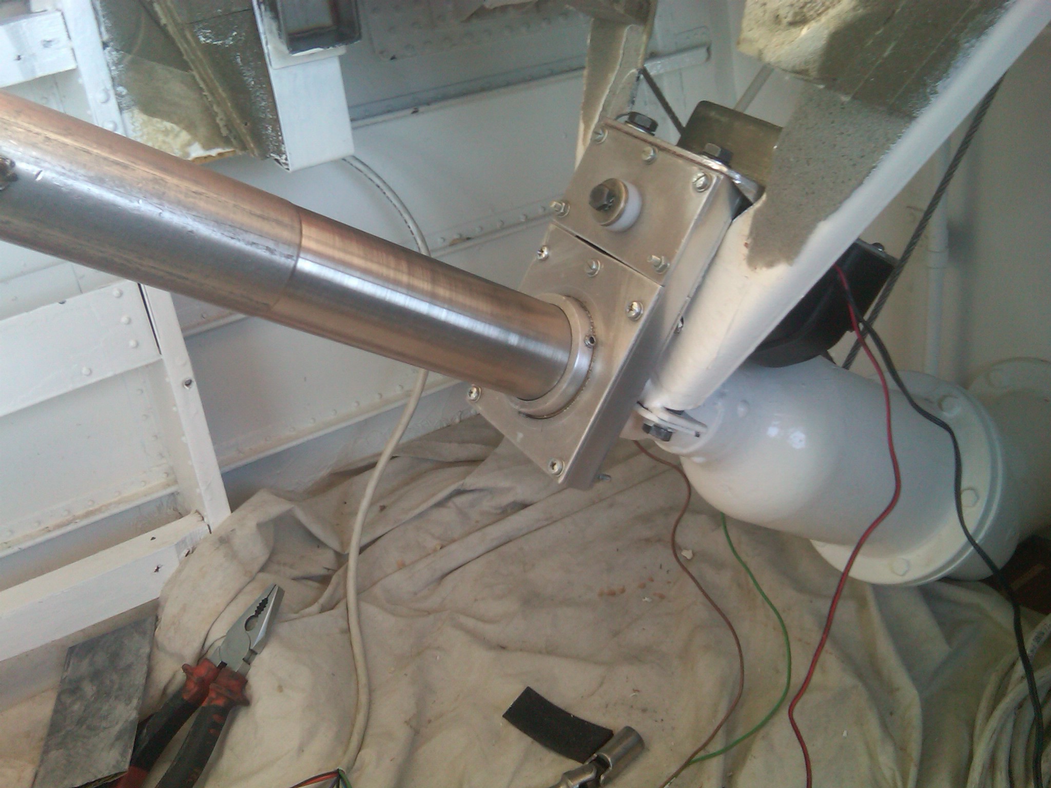

Done ...
Control transmission box
We were fearing that it will touch the shaft, but it was thouching the housing of the aluminium cast steering housing. So there were 5 mm to 8 mm too much we had to the jigsaw to cut it away. A cover was glued on the opening.
This is how it looks when the mechanism is installed.
Now waiting for the connection of the cables.
You have to imagine the same thing with the steering wheel mounted.
