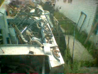

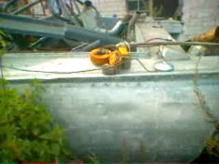

And an outboard engine on a Volga? Ouch! That reminds me of a Volga that I once saw. I was looking for a Volga to buy, and ended up at some carshop. Next to the garage there was a completely stripped Volga, with all parts dumped into the engine compartment, and with a big piece of the stern cut out. Turned out they wanted to put an outboard engine onto the Volga, like you are describing. They never finished the project because, as far as I could understand, because it was much more work to to make the stern strong enough to withstand the forces of the engine, and to make everything look good in the end. I think in the end they wished they never decided to try it like this.
Made some pictures of that boat (on an early camera-phone). Hurts to look at it... :cry:
Hope my comments are still relevant... and if you already bought the Volga or Molnia, then welcome to the club and please upload some pictures!
