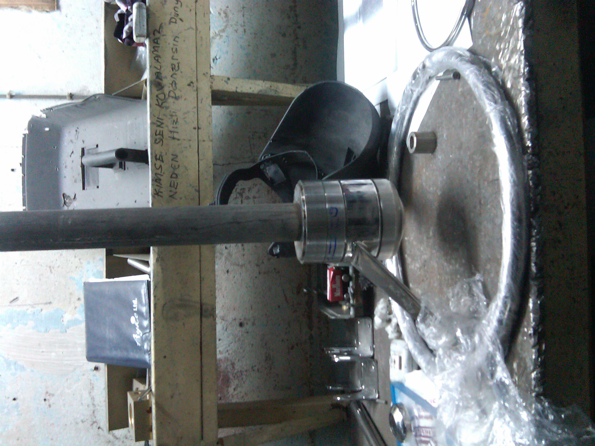

The machined steering wheel, rest is still waiting for finishing.

Re: Electronic or electro-mechanic control of engine and gearbox
Posted: Thu Dec 30, 2010 11:48 pm
Lever moving 90 degrees

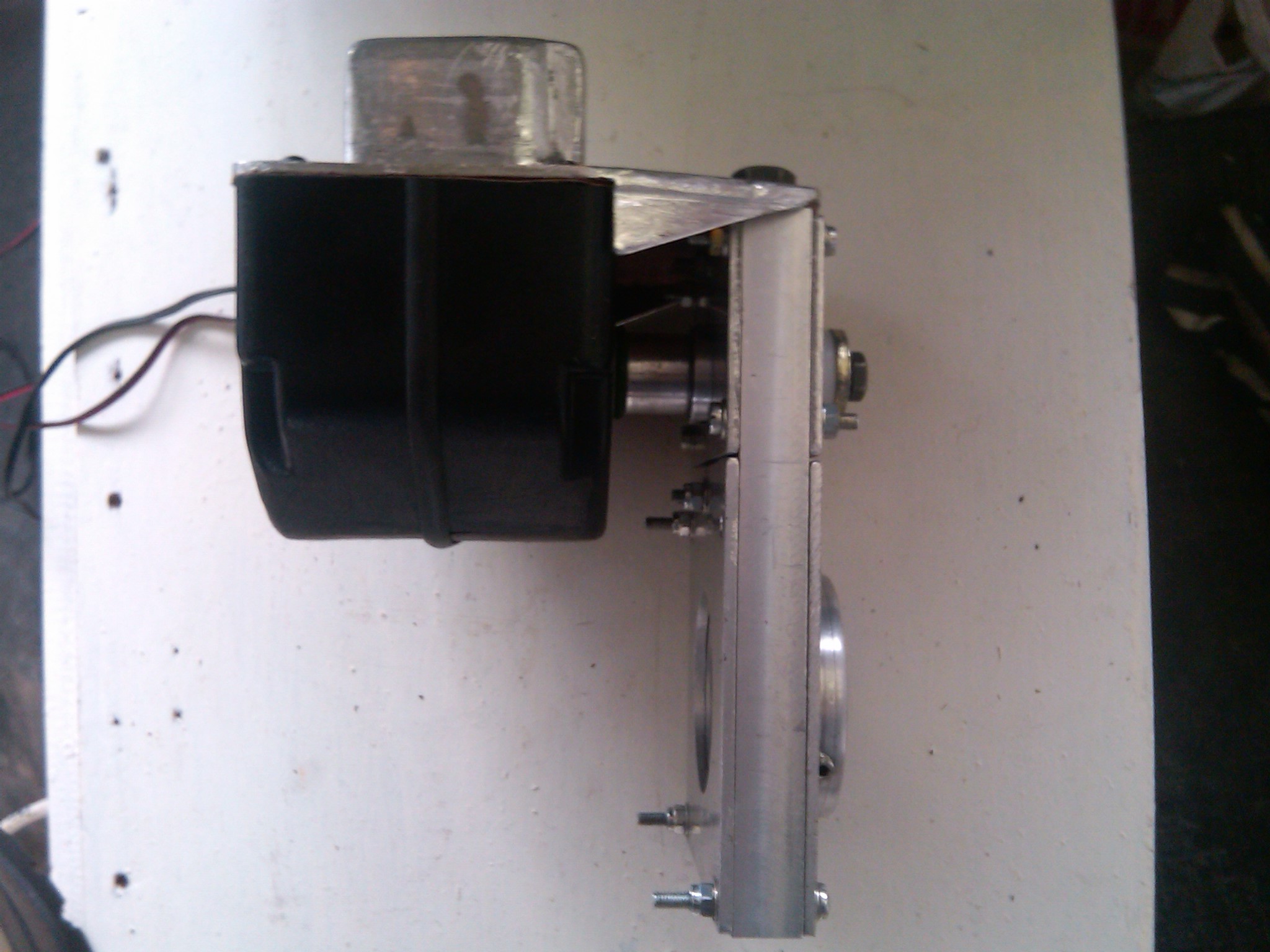

Lever Movement.JPG (16.52 KiB) Viewed 526748 times
90 degrees is steped-up to 160 degrees to move a potientiometer of a ready control head lever (Mathers)
The movement is being transfered via toothed belt drive box.
Trigger belt enables the transmission
Revised mechanics.JPG (27.88 KiB) Viewed 526694 times
The box is out of aluminum and consist of 3 plates, bolts and nuts.
Here is the production drawing.

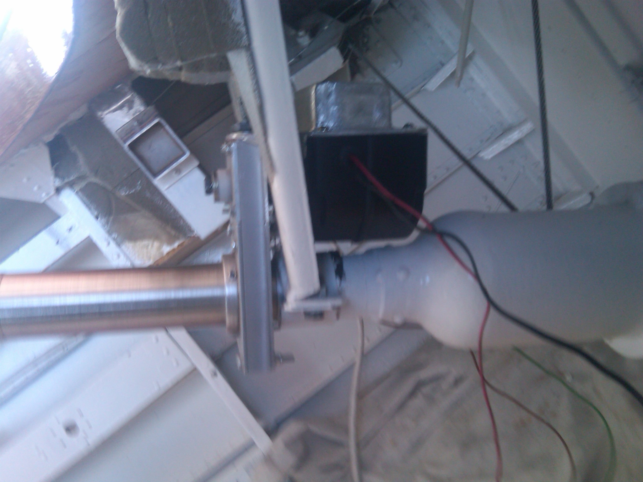

Posted: Tue Mar 01, 2011 9:42 pm
Done ...
Control transmission box
We were fearing that it will touch the shaft, but it was thouching the housing of the aluminium cast steering housing. So there were 5 mm to 8 mm too much we had to the jigsaw to cut it away. A cover was glued on the opening.
Posted: Tue Mar 08, 2011 7:45 pm
This is how it looks when the mechanism is installed.
Now waiting for the connection of the cables.
You have to imagine the same thing with the steering wheel mounted.
Already installed
Already installed
