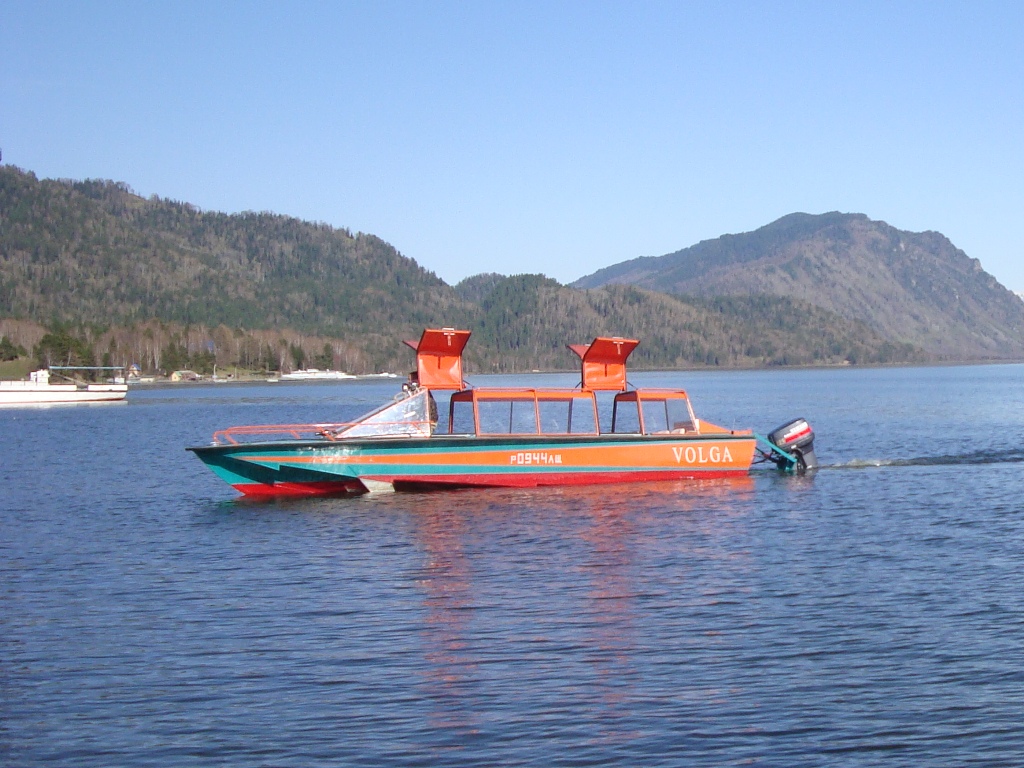

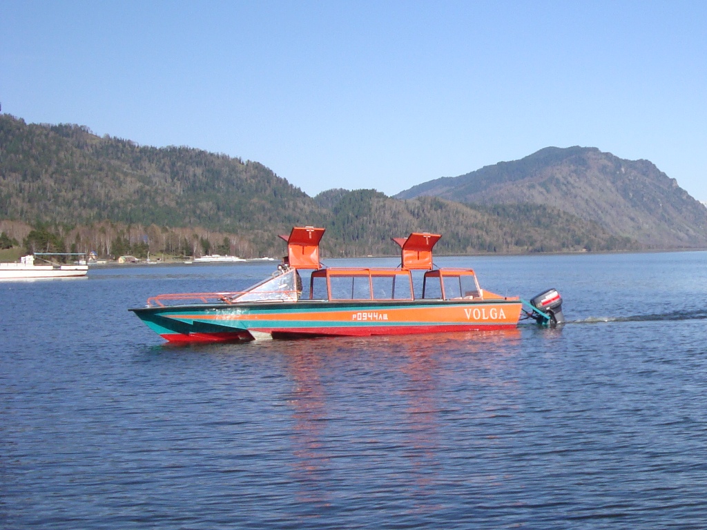

my boat is equiped with an outboard. This was the construction, when I bought it:
The Bracket was bolted at the original engine supports and at the transom a steelplate was added. The outboard engine was bolted directly through the transom. You see a small iron angle for the little "nose" of the outbord bracket.
What I now try is to install a construction to pull the outbiorad up and down, because I want to slip the volga with a trailer:
I'm curious about your solution.

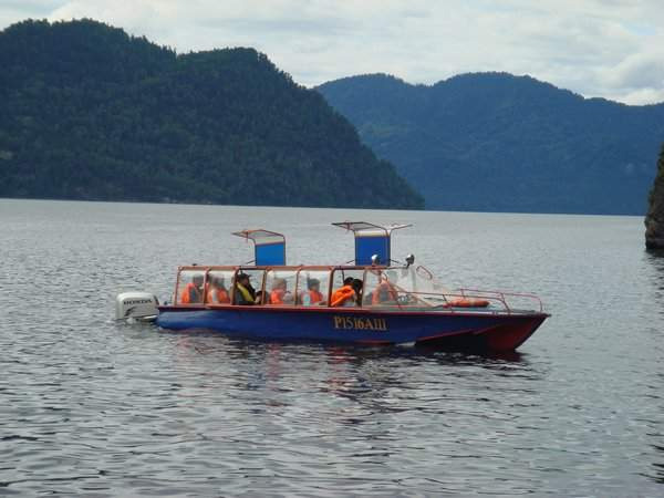

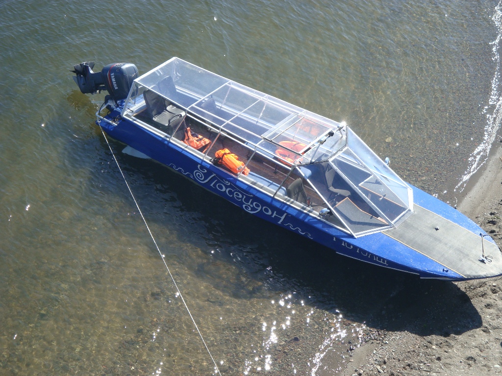

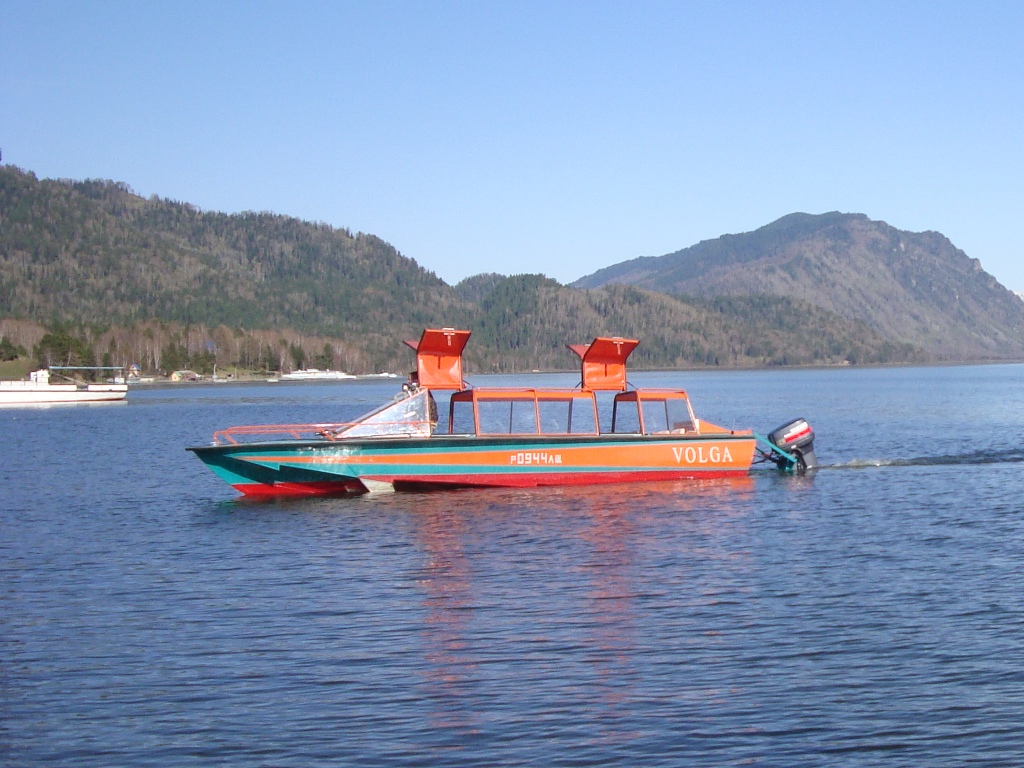

Here some pictures of other outboard volgas:
Hope that helps...
